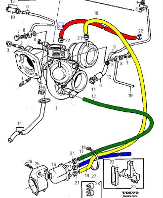

Here is a diagram that was posted on another thread. The MBC will go between the green and the yellow vacuum lines. Be sure you check the condition of your lines.
https://volvoforums.com/forum/attach...7&d=1267663784
If you really want to test your turbo, remove the yellow line from the turbo.
**CAUTION** drive your car WITH A BOOST GAUGE. You be very careful as you are the wastegate. You can feather your throttle and watch your boost rise. Your 15G should be able to hit over 20psi but you will probably hit fuel cut off before then. This test is only to see if your turbo can boost. YOU must be ATTENTIVE and CAREFUL.
As for your MBC. Dont rely on another person settings. After testing if your turbo can boost, install it and begin to adjust it.
I get the impression you are trying to do this without a gauge. Not a wise thing to do. Protect your car, get one.
If nothing changes after these suggestions then I would look at the internal blowoff valve as being possibly weak or torn.

i coulda sworn everything you are telling me to do i have already tried...
the MBC was installed that way
