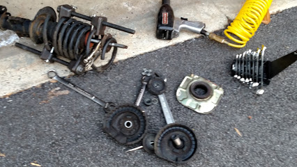

Which brand spring compressor?-16-1.jpgYou can find the "death stick" compressors at Harbor Freight, Autozone (which also rents), Sears etc. I've used them multiple times on 850 struts (and a few others). I have an air gun which helps speed the compressing. The only issue I've had is with my 2000 S40, which has very long springs where I had to use two sets to grab enough coils. 850s are fairly straight forward. Make sure you use OEM or HD spring seats or you will get a fail like the one in my pic. The 850s have a standard top nut (22mm?) to hold the bearing but also have a "cross nut" that holds the spring seat. the top nut should come with the new strut and you may want to buy a new cross nut. Make sure you check the torque spec for both (hard to use a torque wrench on the cross nut without a special tool)

Attachment 13234You can find the "death stick" compressors at Harbor Freight, Autozone (which also rents), Sears etc. I've used them multiple times on 850 struts (and a few others). I have an air gun which helps speed the compressing. The only issue I've had is with my 2000 S40, which has very long springs where I had to use two sets to grab enough coils. 850s are fairly straight forward. Make sure you use OEM or HD spring seats or you will get a fail like the one in my pic. The 850s have a standard top nut (22mm?) to hold the bearing but also have a "cross nut" that holds the spring seat. the top nut should come with the new strut and you may want to buy a new cross nut. Make sure you check the torque spec for both (hard to use a torque wrench on the cross nut without a special tool)
