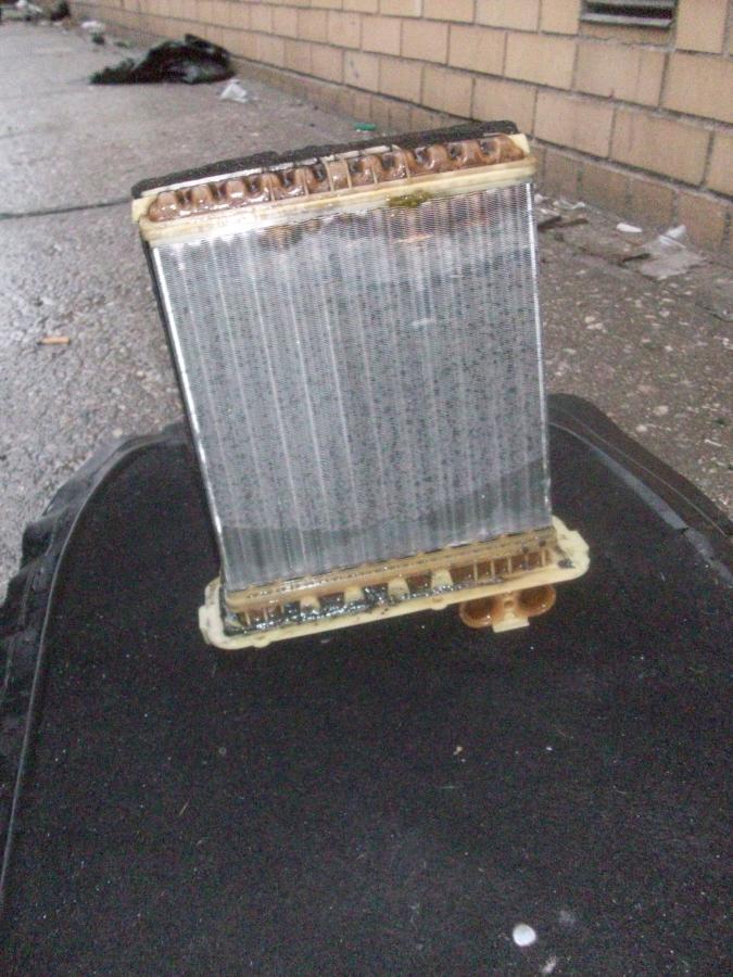

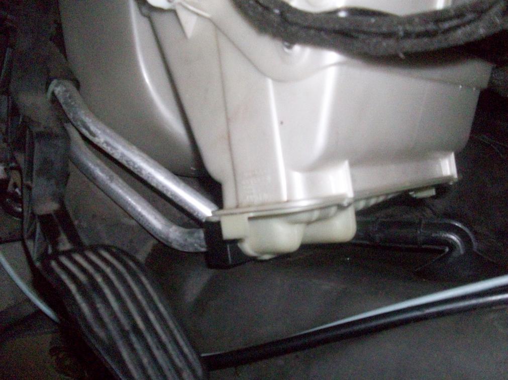

So I got the core today and decided to do it immediately. So I went in. It was real easy to do except for thescrews on the passanger side. Forgot to mention I'm 6'4", 250lbs and the space was not working in my favor. It was a tight fit in/out but it is up and running.
Attached Thumbnails Brooken heater core-100_0404.jpg   Brooken heater core-100_0406.jpg
Glad to hear it! So aren't you glad you saved yourself $700 by doing it yourself?
