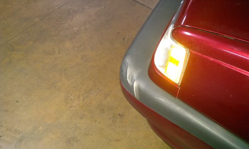

This wrinkle in the trim is the last "eye sore" on my 94 850.
Any recommendations on getting rid of it?
think i could use a heat gun on it? Or should i just replace the whole piece?

You know you bumped a 4 year old thread right?
any way just replace it, it will look better

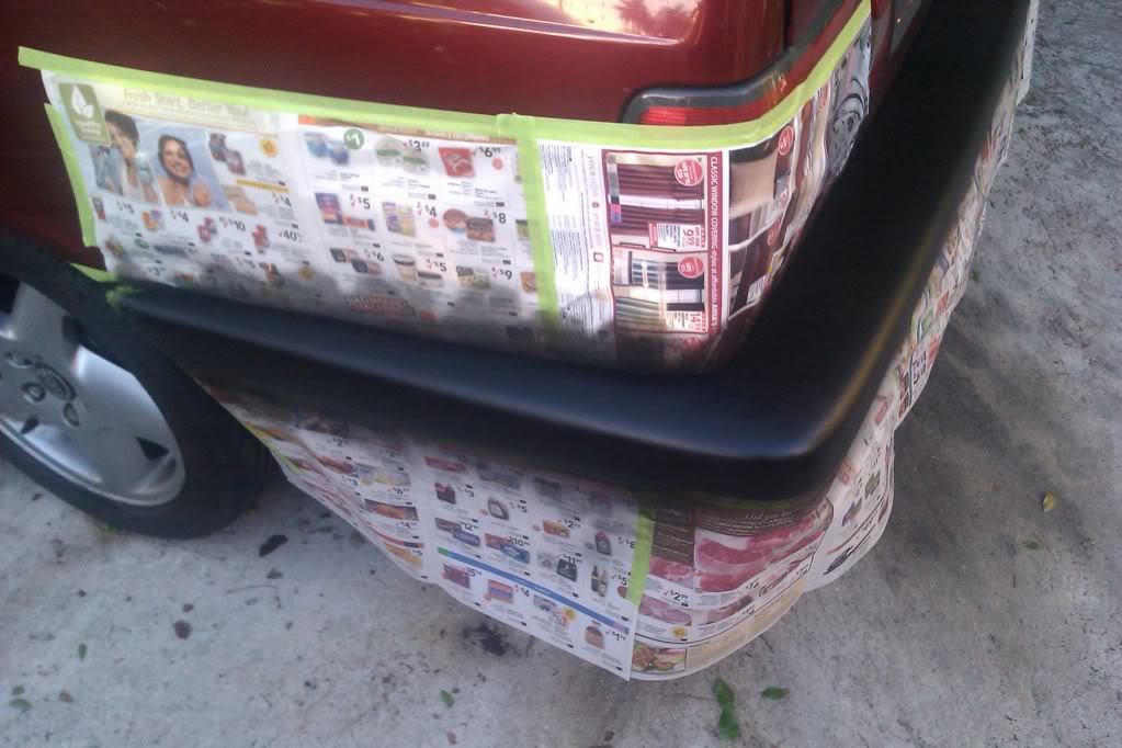

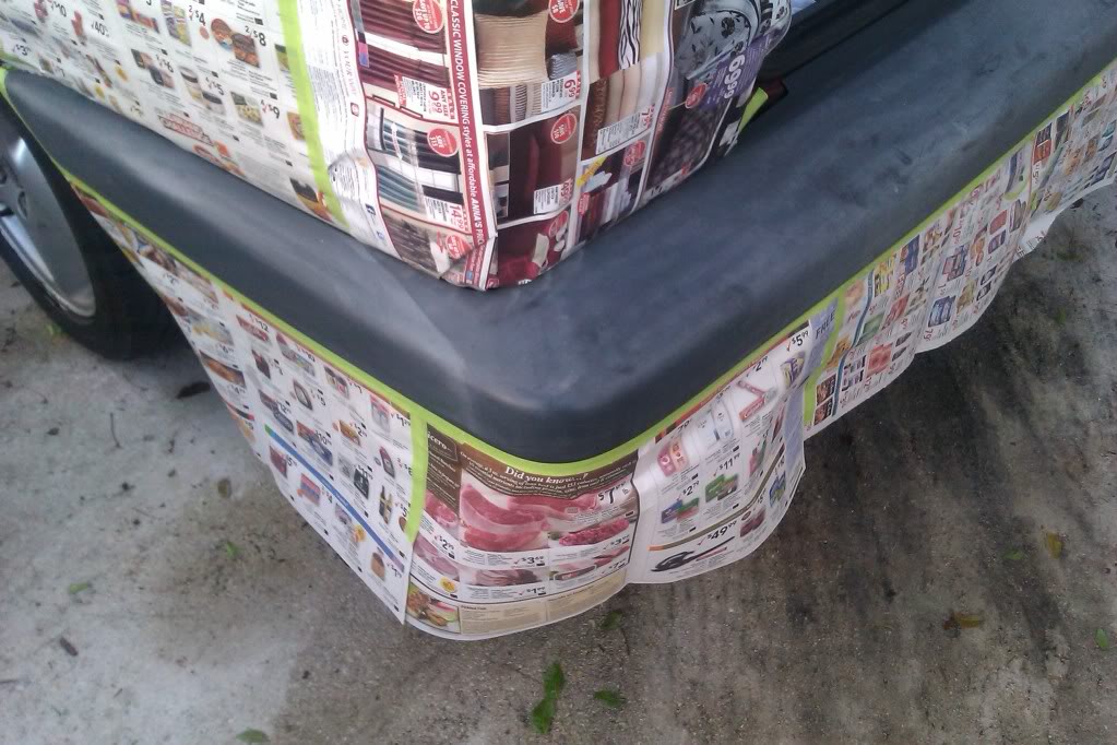

Im actually going to do the bumpers on the yellow next weekend if its not raining.
The red 854 has had them done for 3 years and it hasnt faded or cracked or anything.

Scrub them down good to get all the excess oil off.. Tape it off and then spray... Use light good distanced coats..
Works great on peeling roof trim also
ALSO Make sure you pull the tape and paper off while the plasti-dip is still wet otherwise you will be doing it over cause it will all peel off
