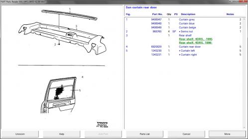

I'm trying to avoid going to the dealer just for that.
Recently I was browsing the common online auction site and found an 850 wagon with what looked like factory roll-up shades for the rear door side windows. They hooked up to the window felt area. I never had a chance to ask the owner if he would be willing to sell those to me separately, but have had a hard time trying to fin d them anywhere, so was looking if I can get a Volvo part number for them. Any help appreciated.

Here you Go
I also attached it so you can print it if needed
Attached Thumbnails Can somebody get a Volvo part number for me?-doorcurtians.jpg
