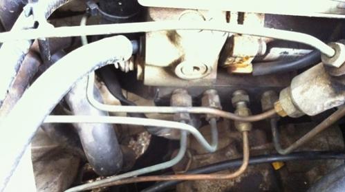

Hi Guys, I have been searching for a replacement abs unit for my 1995 850 T5. Australian Delivered.
The ABS unit is different to all the 850's i can find in the wreckers, and they are puzzled about it too.
The one i have looks just like the ones they have except the solenoid block on mine is a little longer, and has 4 pipes on the side not 3 like all the ones i can find. The later vehicles have a totally different unit all together.
Has anyone seen one of these before?
The reason i need to replace is that it has a massive leak. it had leaked for a while, but the car can not be driven as it looses all fluid now in a matter of hours.

The four port version is for TRACS. I replaced mine a few months back. I seem to remember finding a new unit on line, but for something like $1200. (here is an upside-down picture Volvo 850 93-94 Teves IV abs pump)
I was able to track down a junk yard unit from www.automotix.net/

Are you needing the abs pump or the electronic module?
I need the pump unit.
There is a massive internal leak from one of the solenoids or something.
Thanks,
That clears it up a lot.
I now have something to tell the wreckers!
