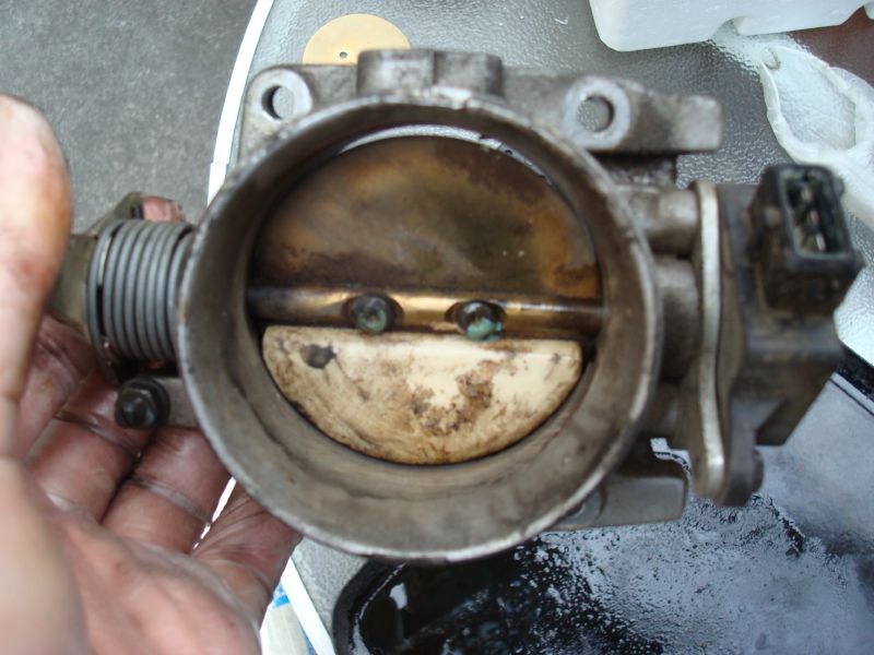

So could a dirty throttle body or IAC (idle air control motor). You might want to pick up a can of throttle body cleaner, NOT carb cleaner and clean those two items.
If not sure about where or how on the TB or IAC cleaning you can google, bing .... for more info. When you clean the IAC remember to keep the motor up. You don't want the crud you're rinsing off the shutter wheel getting into the motor.
