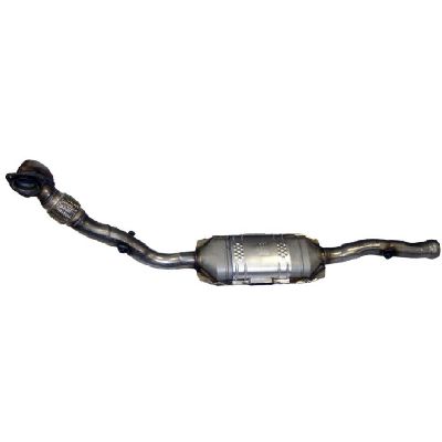

Old Jul 15, 2012 | 06:02 PM
This is a stock converter, comes one piece with the downpipe. If you punch out the converter then you likely will have a constant CEL for catalytic converter efficiency below threshold.

Old Jul 16, 2012 | 05:31 PM
artbar92706's Avatar
Joined: May 2012
Posts: 95
From: SC
Hey Frog,
Thanks for the pic, but mine does not look like that Next week when I get back down there I will take a picture and post it, maybe I am looking at the darn thing wrong? I am almost sure that this thing is unusually huge!

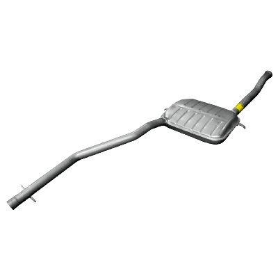

Old Jul 16, 2012 | 06:36 PM
Originally Posted by artbar92706
Hey Frog,
Well,,,, the muffler is the size of a suitcase.
Old Jul 16, 2012 | 06:41 PM
Joined: May 2012
Posts: 95
From: SC
lol, yes it is, I remember staring at the thing the first time I met it!
Old Jul 17, 2012 | 02:44 AM
ibified's Avatar
Joined: May 2010
Posts: 1,712
and it weighs about 900 lbs. at least it feels like it when you're under the car trying to lift it into place...
