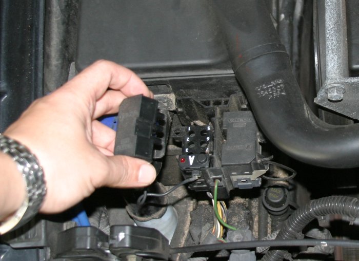

Do you know if you have the self diagnostic panel under the hood by the washer fluid fill neck? See picture.
Being a 93 it should have it.
Since your recirc and AC lights flash now and they didn't before I'd swap your old one back in as the one you picked up might be in worse shape than your old one.
Bad news is why it would work when you first turn to "On" but once it's started and returned to "On" it's dead. I can't think of what would cause that.
It still sounds like it's the ignition switch.
How to use that diagnostic panel:
http://www.volvoclub.org.uk/tech/ser...ystem-Auto.pdf
