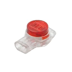

After a few trips in the car I now see that the trip computer is not working. I guess my splice job failed and I'll have to tear into that dash again. I'm going to remove the dash pad, install an stand alone air bag and leave the pad off till I get this all sorted out. I didn't strip the wires when I spliced them together with the phone splice connectors. They are like the pic below. They even have a grease in them that goo out when you clamp them down.
