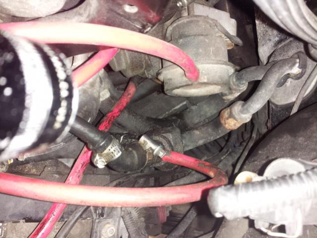

Hmm...pulled off intake and found this: possibly the heater core lines that are leaking?
They feel a little "gooey" for lack of a better word....

Could be the heater hoses or the supply or return for the turbocharger. Get a coolant system pressure tester so you can pressurize the system to find the leak when it isn't hot.

Got the coolant system pressure tester.....that didn't take long to find the leak - a little tiny hose (about 6" long or so) that appears to come off the back of the block and connects to the turbo. It has a right angle (almost) in it, and it was a giant pain in the rear to get to, as it was tucked behind the heater core hose. Anyone know what this hose is for? If it matters, it's a 1994 855t with a 16t turbo on it.

its the turbo inlet cooling hose.
Its a common popper, I know 4 people not including you who have had this happen in the last week.
Its a easy fix from underneath.
Volvo 850 Parts | FCP Euro
The dealer should have it for around $7
