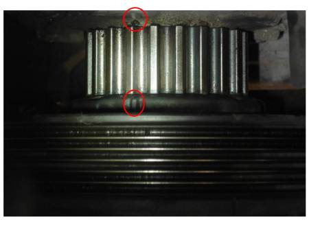

Since you found the belt off by four teeth it's almost a certanity that it's the likely cause of the no start. Pull the cover again and confirm.
My guess is one of two things happened. Either the tensioner is failing and allowed the belt to slip or something is causing the cams or crank to bind.
More time and money ? More time yes. First find out what and then you can decide if you have the money and or want to do what the repair will be. Find out if the belt did slip again and can you post the compression results? It's likely the valves were bent and if so you'd need to pull the head to have it repaired. There's always a chance it's something else that failed that caused the current problem. Not likely, but possible.

Attached Thumbnails Could it be the timimg belt tensioner pully??-timing-belt-cam-marks.jpg   Could it be the timimg belt tensioner pully??-timing-marks-crankshaft.jpg   Could it be the timimg belt tensioner pully??-timing-belt-ripped.jpg

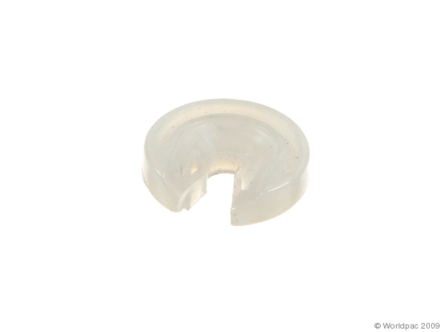

What shape were the rollers in?
Also, did you install the white plastic clip on the tensioner tip?

Like this- - - >
Attached Thumbnails Could it be the timimg belt tensioner pully??-timing-belt-tensioner-disc.jpg   Could it be the timimg belt tensioner pully??-timing-belt-tensioner-disc-installation.jpg

Thanks Kiss, sometimes I respond on my phone and it's hard to link pics, etc.
That plastic piece is designed to prevent the tensioner roller from giving enough slack to cause the belt to jump any cog teeth.
