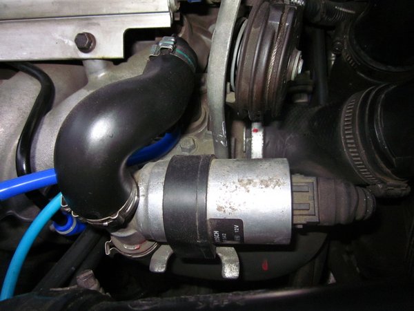

Are you still getting the crank sensor code ??
Due to the "gunk" and missing air filter I would buy a can of MAF cleaner and clean off the Mass Air Flow Sensor.
I'd also pull and clean the Idle Air Control valve/motor.
Also pull the hose and clean in place the throttle body and plate. NOT with carb cleaner!
I would also buy a pressurized can of Seafoam to spray into the intake while it's running any way you can get it to so as to clean up some of the crap in the throttle body and intake and the bottoms of the injectors.
At this point I would NOT replace an injector. Like you said unlikely five died at the same time and dirty can be cleaned.
Were you able to check the fuel pressure while it was running for the brief 15 seconds to see if your pressure dropped ?? Static pressure might be higher than when the system is trying to use it. Might be dropping below what's required to operate.

I am still getting the crank sensor code and I wasn't able to get the fuel pressure reading while it was running but I will try too
