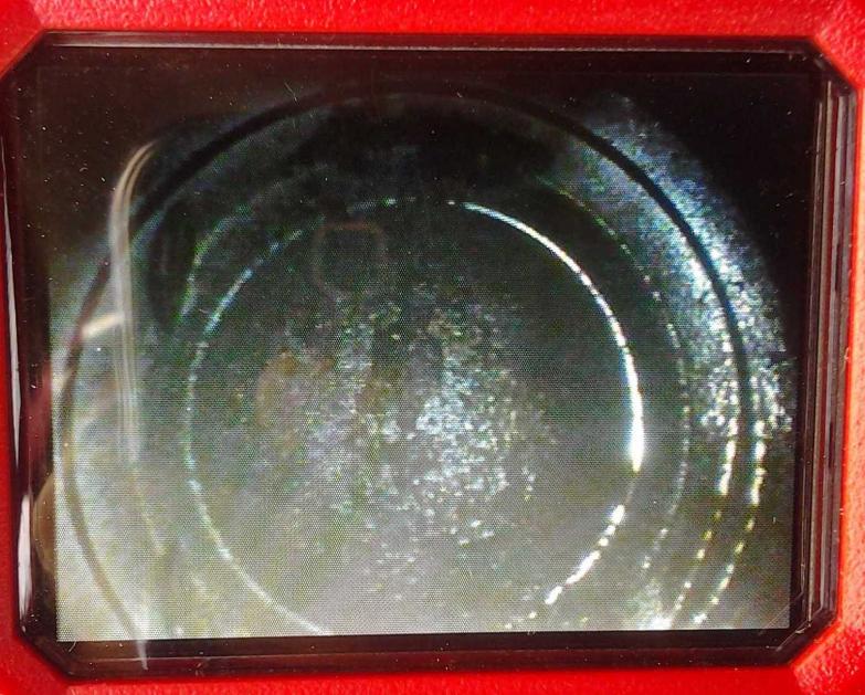

I couldn't get a good picture of the valves through the plughole but I was able to get a good look at the piston. This is the only oddness I saw, in the bottom right corner (hopefully it isn't camera/glare trickery)...this is at the bottom of the stroke btw...And I also still have to do a proper leakdown test...

So after months of running around with the misfire I finally figured it out. It IS a burnt valve...
I couldn't get a good look at the valves through the borescope so I bought a #000 (10mm) and #00 (12mm) SS dental mirror...
I stuck the mirror into the plughole and snaked the scope in after it. It took some maneuvering to get a good look at the valves but it worked! The intake valves were fine but there was a chip out of the passenger side exhaust valve on cylinder 5, pictured below...
You can see about half of the valve and a chip...
Surprisingly, the car runs relatively well with the constant misfire at lower rpms. And I commute 50 miles a day to work. I am sure it probably isn't good to keep driving like this but it hasn't gotten worse and I am only noticing low mpgs(around 20 combined when I was easily get about 26)
Time to coordinate another head teardown
