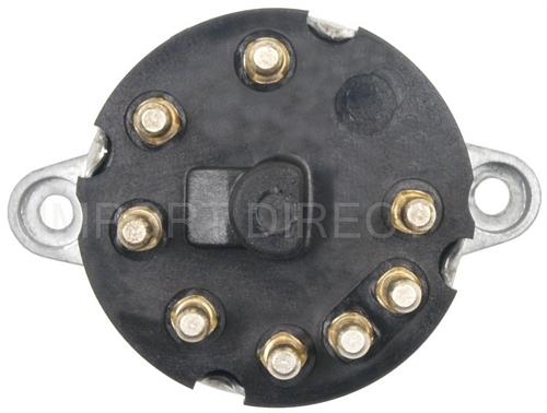

There is a good chance you might have a bad ignition switch. Next time it happens try to turn the key a bit forward and or backward in the run position. If the lights go out it's the switch starting to go bad.
This was actually another thing I tried while driving back home as it was the only thing I can physically test while driving. the key doesn't really budge any amount to cause the lights to turn on or off...
