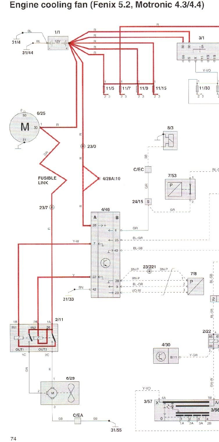

On the diagram the relay is 2/11 mounted on the fan shroud, and the fan motor is 6/29. Check for 12 v at the big red wire on the relay. And try to apply power to the red and the green wires (for the two speeds) going to the fan to test it. I have seen bad fan motors or with only one fan speed working, and plenty of bad relays or melted connections. Never a bad fusible link but it's possible.

Thanks for the quick reply hoonk, I tried to ck the ECT sensor for corrosion and when I disconnected it ,or tried the two pins pulled out of the sensor and are stuck in the connector end. Wires are still intact so ill see if I can plug it back in. Ill ck codes again to see if that has thrown another code. If not I'll check the fan connections. Although I will say I'm no tech but maybe after comparing the schematic while looking at the fan I might be able to find the connection that might be bad.
