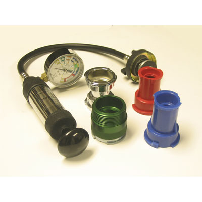

Any chance you can post a picture of yours?
It's likely they just disconnected them from the coupling and left it alone. The heater core is most likely bad ,,, usless someone was really cheap and had just a leaking hose and instead bypassed the core ?? No way to know for sure unless you hook it up and either run it or use a tester to pump up the system and try to listen for a leak (air pressure). You can get a loan of a pressure tester from Oreilly or Autozone.
http://www.matthewsvolvosite.com/for...hp?f=1&t=24390
http://www.matthewsvolvosite.com/for...hp?f=1&t=41666

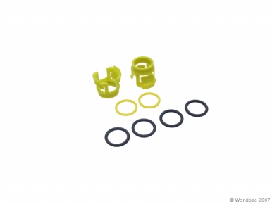

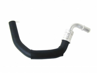

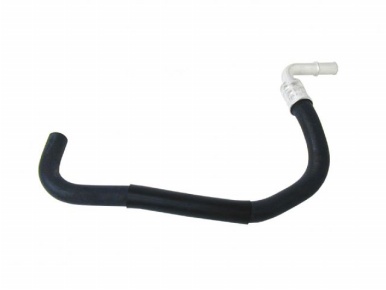

If you go with used hoses you still might want to consider picking up a new seal kit. Just a thought.
Attached Thumbnails Excited new 850 glt owner!-heat-ac-heater-hose-inlet.jpg   Excited new 850 glt owner!-heat-ac-heater-hose-outlet.jpg   Excited new 850 glt owner!-heat-ac-heater-hose-seal-kit.jpg
