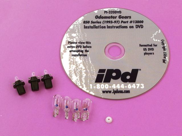

You just need the one gear. For the trouble of taking it all apart I'd just replace both. That and do the instrument bulbs too. The fewer times you take the dash off the fewer things you have a chance to break !!
Attached Thumbnails failed odometer in my 1996 850 turbo-odometer-little-gear-ipd.jpg
