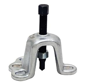

It's a pretty easy job as long as the shaft will come out of the hub. If it's stuck, use a puller. You can get one the same time you're getting the torque wrench and it's a loaner so you get the $$$ back.
DON'T hammer on the end of the shaft. If you run out of "play" in the joints you are pounding straight into the transmissions guts.

Hammering to get the shaft out of the hub is fine as long as you don't mushroom the end. It isn't going to do anything to the transmission. If it's the passenger side, the axle is held in place with the carrier bearing. It can't go into the transmission any further. And if it's the driver side, it still isn't going to go any further into the transmission.
