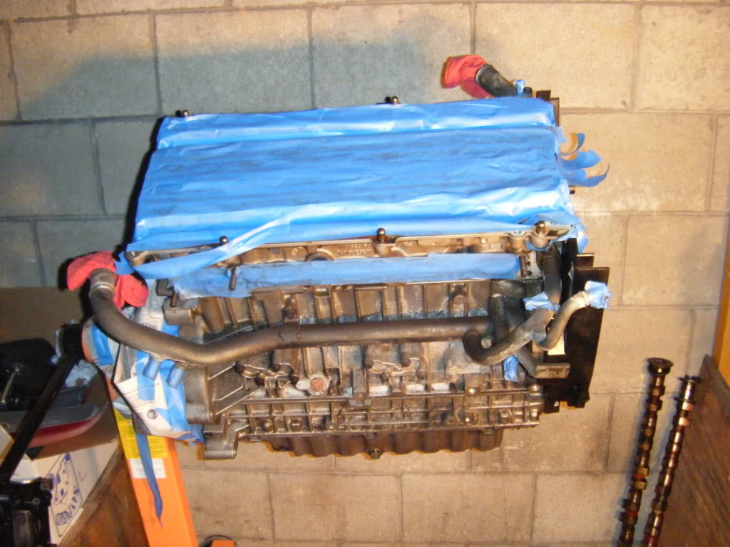

Well, if you've never touched or moved everything when the belt was off, it shouldn't be out of time. I guess really the only way would be to do this:
With the cams out you can spin the crank to realign the timing mark, and then when you drop the cams back in, set them correctly and it will be back in time. But if you never touched it, it shouldn't be out of time.
