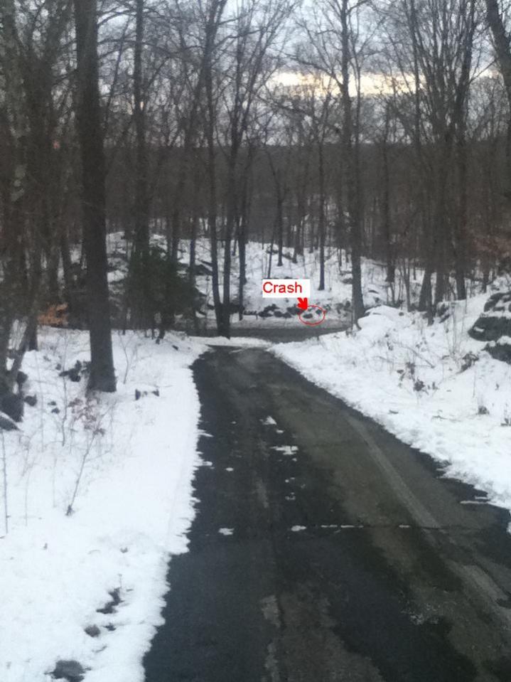

Nice Continental runflats -- car slid uncontrollably down the snow-driveway -- hit a rock, airbags exploded, etc etc. I was actually surprised that not more damage was done. Have driven many cars down this driveway, never ever had this with any other car.
Parts for interior (airbags, seatbelts, clockspring, module) and bumper assembly. Plus supplies: about $ 700. Quite a bit of body work. Halfway with Stage 1 (just about to do the timing belt and PCV).
2nd option: 1995 NA Wagon, 220k miles for $ 700, which will be about $ 1000 after titling, inspection etc. Seller says it needs a CV (which comes with it).
Mine is a Turbo, but honestly, at 15-16 years old car, plus that I do not race it, I would be perfectly happy not to have it, but if the NA is a real dog, then I guess I need the Turbo.
Advice?
Attached Thumbnails Fixing this or getting another one-crash-photo-1.jpg   Fixing this or getting another one-crash-photo-2.jpg   Fixing this or getting another one-crash-photo-3.jpg   Fixing this or getting another one-crash-photo-4.jpg   Fixing this or getting another one-crash-photo-5.jpg

I added some photos to the 1st post. I am also adding another photo here...

Crash was slow speed, I would say maybe 20-25 mph. I does pull to the left now, although manageable. I examined the car today at length... There is no structural damage, although some things need to be fixed.
