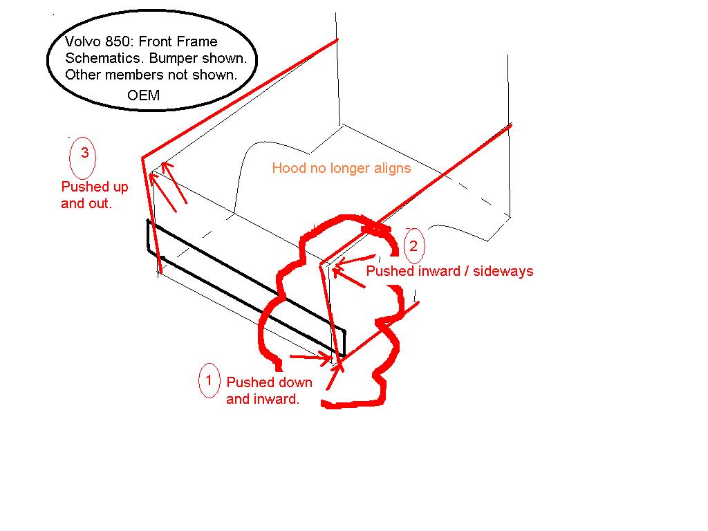

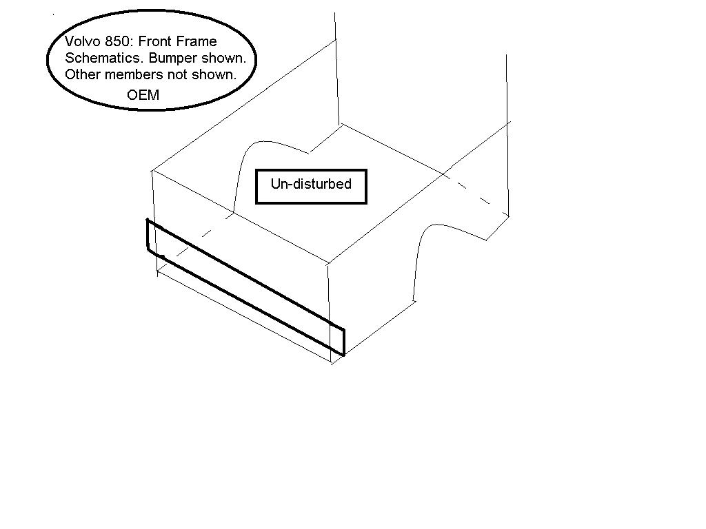

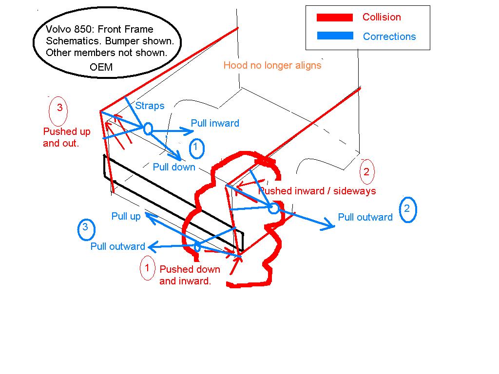

Last night, I played the collision forces in my mind. Here are some schematics. I will try a different strategy:
1- Pulling has to start in the opposite sequence of collision.
2- Rather than hooks on the holes in the frame, I need to use straps that wrap around.
3- Bumper acts as a perimeter /spandrel beam. Bumper has to be removed to allow correction of the side frames.
Attached Thumbnails Fixing this or getting another one-volvo-850-front-frame-oem.jpg   Fixing this or getting another one-volvo-850-front-frame-collision.jpg   Fixing this or getting another one-volvo-850-front-frame-damage-fix.jpg

For those of you following this thread-- in terms of collision measurements: the left front frame has moved towards the right about 3/4", and towards the center about 1/2".
The right-front has moved outward about 3/4", and toward the headlight about 1/4".
The break has occurred somewhere between the shock towers and the windshield.
On unibody cars, like the 850, once the skin is punctured in collisions, there will be frame damage. I learned that insurance companies would have totaled this car. But since I was carrying only liability on it, it becomes a throw-away.
I did not price up a frame-straightening job from a shop. I researched and it would have been cost prohibitive. The fenders, radiator etc, front support and a few other things would need to be removed for the straightening to take place. Either the shop does it, or I do it and tow it to the shop.
