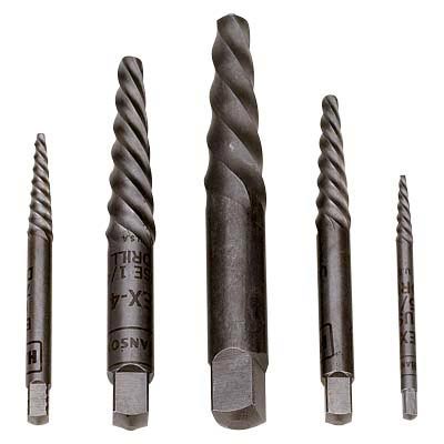

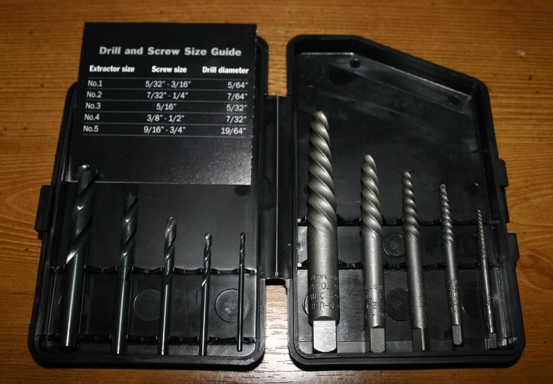

Heat from a torch works pretty well for breaking frozen bolts loose. Saturating them with a penetrating oil like PB blaster (NOT WD40) is also a good idea. For the ones with no head usually drilling a pilot hole and then using an "easy-out" would be the answer. An easy out is built backwards so that it tightens as you turn it backwards in the broken bolt.
All else fails you might need to just drill a hole and tap it or use something like heli-coil inserts to create something to screw a new bolt into.
