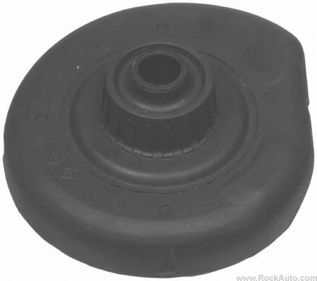

It's the spring seat or strut mount. Many people describe the sound as one of an old wooden ship. If you open the hood and push down on the finder to make the car bounce, you may see the top of the strut going up and down, which would be bad. Also, you may be able to turn the rubber part that the bolt is attached to, which is also not good.

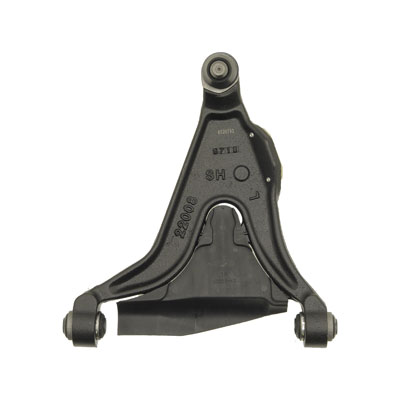

From all the posts and info it doesn't sound like brakes at all. It's likely something in your suspension that has play in it and is shifting one way when you brake and another when you let up.
The upper strut mount is a good place to look but also the bushings on the control arm where they mount to the frame could be another.
Attached Thumbnails Front Creaking Noise..Brakes?-suspension-front-strut-mount.jpg   Front Creaking Noise..Brakes?-suspension-front-coil-spring-seat.jpg   Front Creaking Noise..Brakes?-control-arm-lower.jpg   Front Creaking Noise..Brakes?-control-arm-lower-bushings-only.jpg

That upper mount/spring seat is worn out. I've read of people using washers to try and tighten it up but the best bet is to replace that worn out spring seat.
Attached Thumbnails Front Creaking Noise..Brakes?-suspension-front-coil-spring-seat.jpg   Front Creaking Noise..Brakes?-suspension-front-strut-exploded-diag.jpg

A better way to check the spring seat is to take a 21mm wrench and try to turn the nut on top of the strut. If it turns all the way, the seat is torn. Just having some movement when bouncing does not indicate failure.

The shiney part is the cross shaped nut under the upper washer. If the was the sleeve from the spring seat, there would be a lot more play and a ton of rubber shavings all over the place most likely.
It certainly can be the spring seat, I'm not saying it isn't. I'm just giving a more definitive way to tell if it is bad. If you put a wrench on the nut and turn, it should move slightly and then stop. If you can spin it all the way around, the spring seat is busted.
As for how much play, Volvo doesn't have a spec for something like that. I check them as mentioned above. You can also remove the nut to visually check for a broken seat or use a pry bar under the washer to lift it and peek in there. Using a wrench is the quickest way though.
