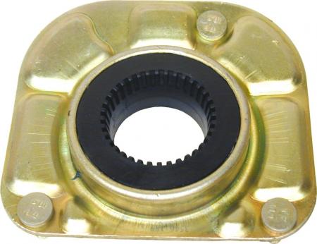

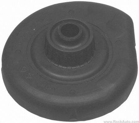

Also what about the metal suspension strut mount?
There is the strut mount and the spring seat. The spring seat is rubber and can wear out as can the strut mount. The strut mount has a bearing that allows the strut to swivel to allow for steering. Those bearings can wear out and cause a squeak when turning or knocking when going over bumps.
