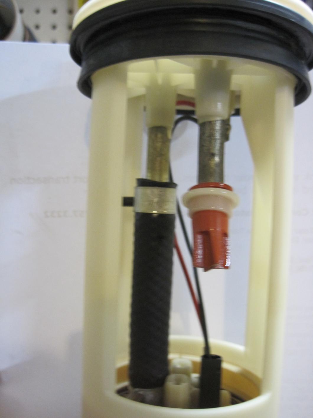

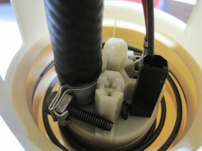

I have a 94 850 GLT Sedan that needs a new fuel pump. I have removed the old pump and I need help on replacing the pump.
This is what is in my gas tank today:
Fuel Pump-entire-fuel-pump-volvo850glt.jpg Fuel Pump-img_2552.jpg Fuel Pump-pump-top-view.jpg

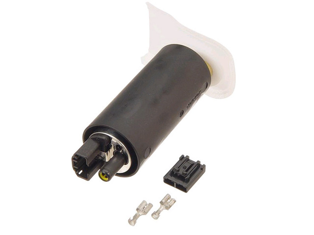

Can I buy this pump and re-use the housing and save myself some $:
Bosch Fuel Pump Insert FWD P80 850 C70 V70 S70
I really don't think I need to spend about $400 on a new entire unit.Volvo 850 Fuel Pump Assembly- Volvo Parts
But, I'm unsure on the electrical connections on the Bosch pump. The pictures on the Bosch unit look like it will work but I'm not sure.
Can anybody that has replaced their fuel pump give me their 2cents?

If you purchase(d) BOSCH Part # 69693 it should be a direct replacement for the pump. It should have instructions inside the box on how to hook it up but usually the connections are pretty clear so you don't wire it backward.

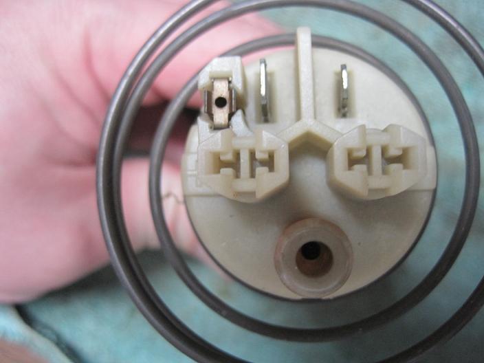

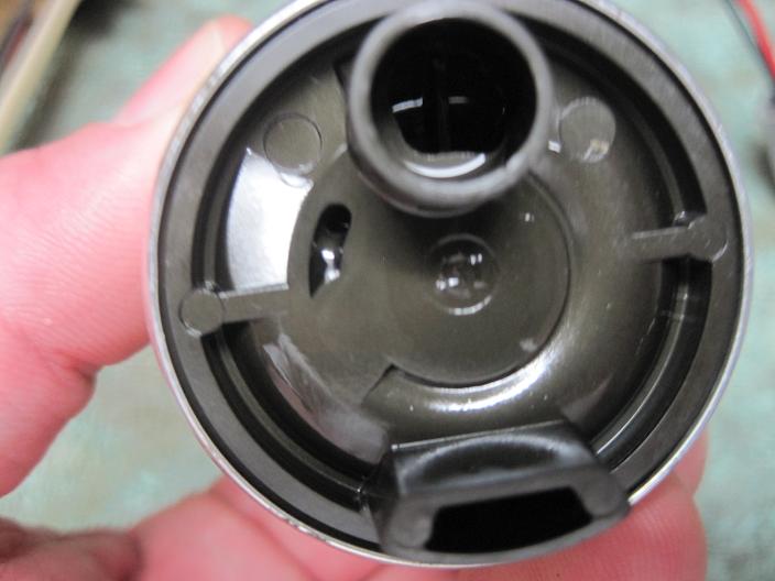

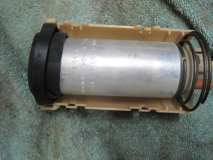

I finally got around to removing the actual fuel pump from the plastic housing. I was careful and did not break anything.
I double checked the IPD website to figure out what pump to order and the model number stamped on my Bosch pump does not match any of those listed on IPD's or Groton's website. The diameter of my pump is 42mm and it's model number is 0580453037. It is my understanding that there are two sizes of pumps, diameters of 38mm & 42mm, correct?
So what pump should I order from IPD? Product Search
Here are some pics.
Thank you all for your help.

The two pump sizes for the 850 are 38mm and 43mm, so I would go with the 43; this one..
Like I said in the other thread I referenced earlier; you will need a short section of fuel line (the old one will be a tad too short), make sure you observe correct polarity and make good electrical contact when you hook up new wire connectors too.

This is the interchange I found on your pump number:
0580453033 Bosch
0580453037 Bosch
3501615 Volvo
3501619 Volvo
9135418 Volvo
9135605 Volvo
0580314067 Bosch
