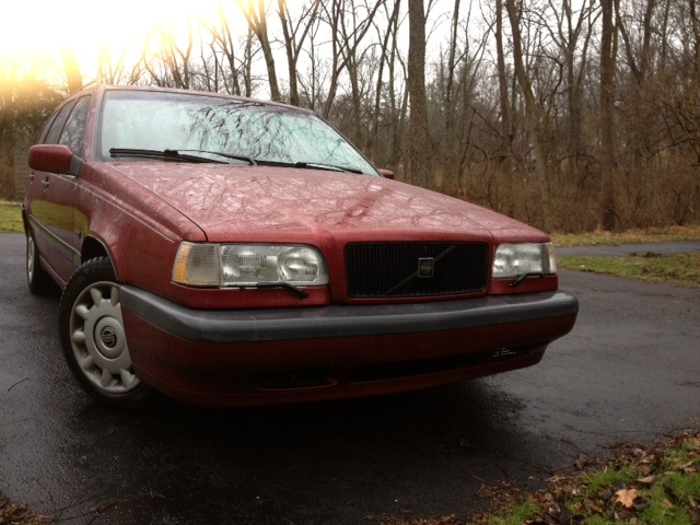

Here's a photo (from last year) with the winter tires and wheel covers:

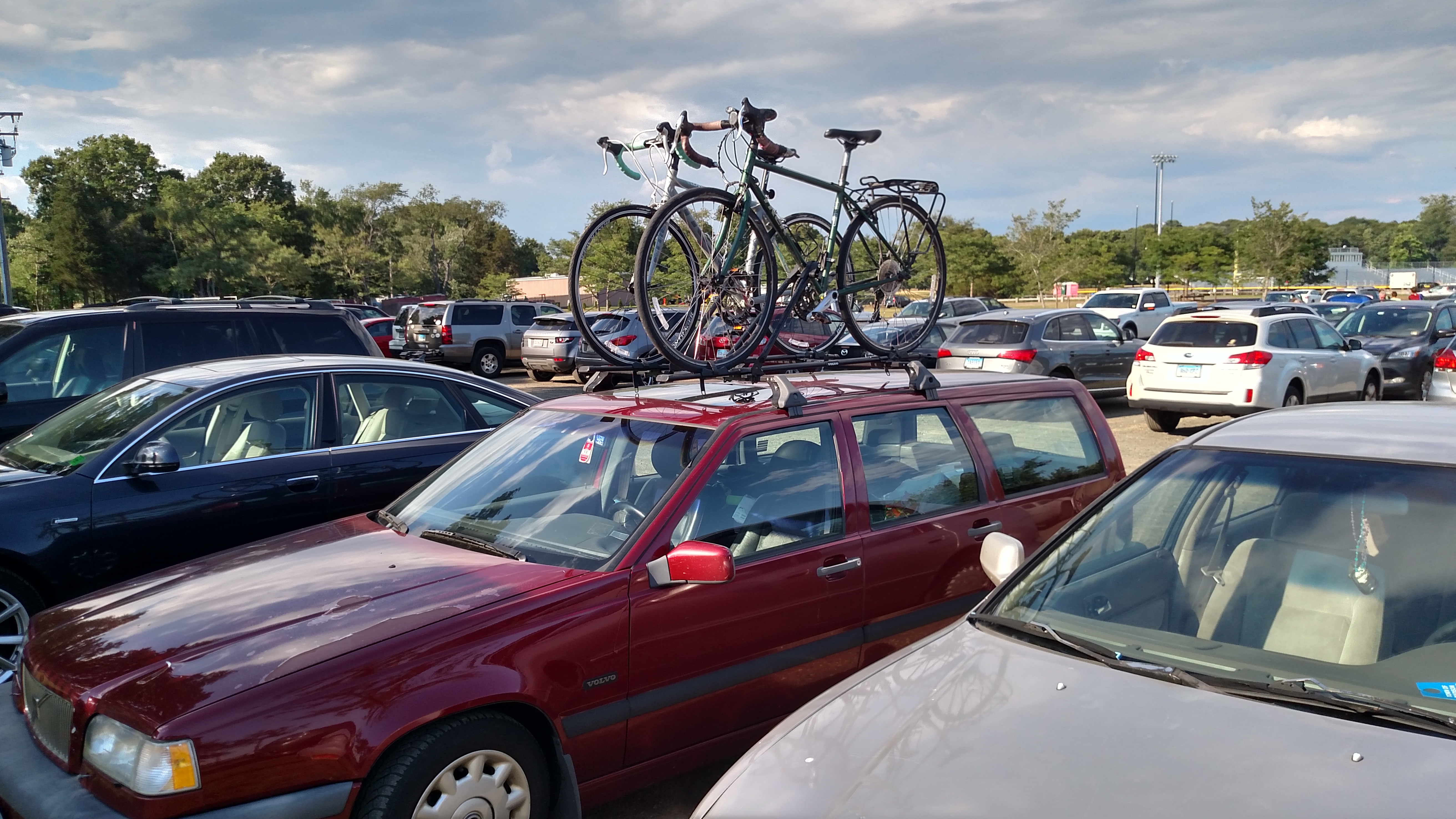

moaning at 30-40 mph could be a wheel bearing starting to give up... or it could be those snows ur running :-) - I have the factory removable roof rack - no rails (really nice - they have pins which fit into the top of the door frames) - I do get some noise with them but its more of a whistle than a moan. (usually have a bike or 2 or 3 up there when the rack's on...
