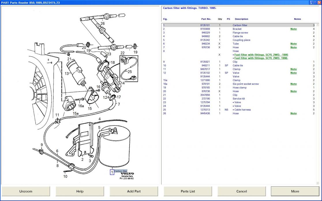

That is the Charcoal canister or carbon filter...what ever they call it. I believe it is for Emissions....but tech would knkow for Sure!
Example:

I wonder of the evap valve is bad.

which valve tech? the number 24 one on a pict?

Yes the 24 one in the pic.
That one port is supposed to be open. That is for fumes to escape if something is wrong with the system.
There is something wrong in the system.

gotcha, yeah there is a lot of fumes coming out of that hole, im afraid im gonna blow up one day, at least i found it, now im gonna mess with it until i fix it. any idea on where to get a new valve? or is there any codes suppose to pop up if something wrong with it?
thank a lot tech, i really appreciate your help.
thanks TIPSP for diagram!

FYI......the pic is from a 95 850 (B5234T5)...assuming they use the same setup?
