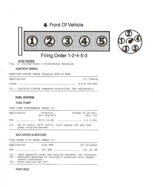

If you are using the Haynes manual for this process the spark plug numbering on the cap is dead wrong. If it will start at all it will run like crap.
Try this from bay 13 which is correct:
http://volvospeed.com/Repair/sparkplugs.php
...Lee

>idiot lights maybe im the idiot
You're not alone. I often feel that way myself.
How about a page from the factory manual? See attached.
JPN
