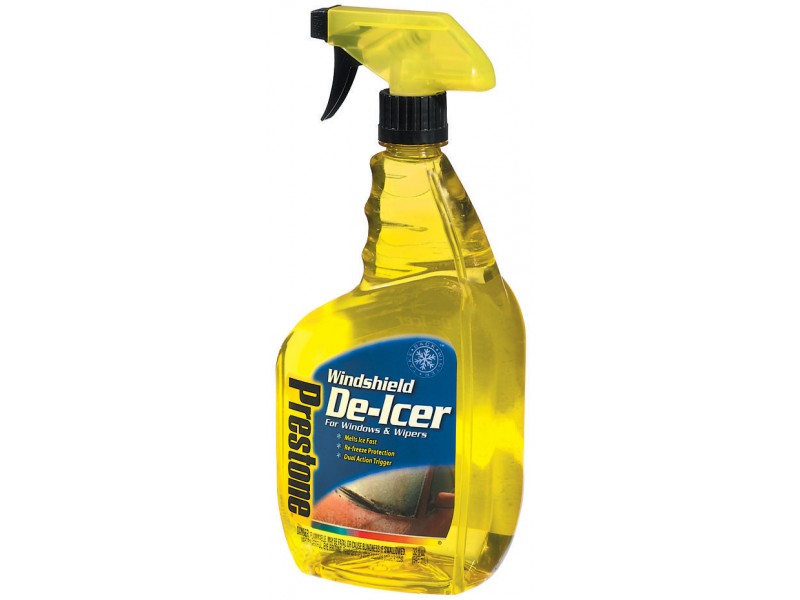

This is no replacement for some OEM heated mirrors but I carry this stuff for my windshield as it works fast and I don't have to wait for the engine to warm up to see out my windshield and I can get on the road faster. It's also so much better than having to scrape ice and works on all the glass and mirrors.
Only down side is it does leave a bit of an oily residue, like antifreeze but it's never bothered me.
Also works great for getting a window unfrozen for getting the mail out of the mail box, banking at the drive through or picking up coffee from a drive by kiosk.
Nothing worse then having the window frozen solid when you pull into a drive through.
