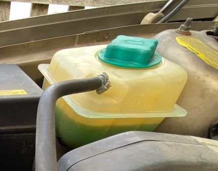

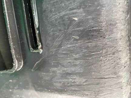

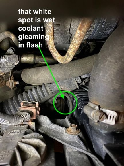

Pics help? Here's some I took while trying to find leaking.
This is what's missing daily after sitting overnight since sub-zero temps.
This is the leaking from under the radiator
top hose on radiator side
radiator shroud drips coolant
coolant wet on shroud

sounds like you have a radiator or coolant hose leak not a head gasket issue. A proper shop can pressurize the cooling system as a diagnostic test to help ID where the leak is coming from. As to the head gasket goes, as hoonk noted that's usually a byproduct of an over heating event. Assuming you've owned the car for a while - have you ever had the car overheat on you? Its not unheard of for a replacement after-market part (like a radiator) to fail or for a tech to not properly tighten or seal the hoses, or for the replacement part to be a poor fit. I'd probably be looking for a second shop to check out the source of the leak.

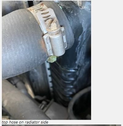

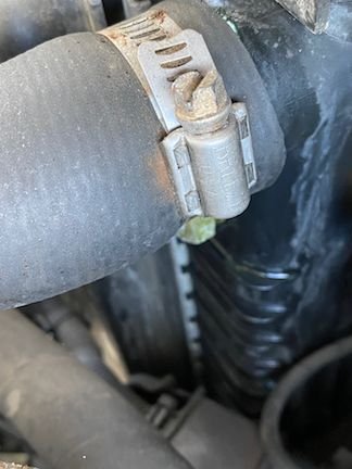

I got back from Ithaca (only 35 miles each way but over an hour drive each way due to small towns) And again had the same amount of coolant leak from under shroud overnight as pictured above.
I did not use it yesterday and a teeny bit leaked as of this am.
Today I looked again at all the connections and the big one at top of radiator (reservoir side) was wet and there was dripping coolant down radiator. I tightened the ring connector as tight as I could and leak is now a hint of a spot. I idled the car for about 20 minutes and the connection and radiator corner were dry. I forgot to wipe down he shroud thing so will now do another idle and see if it still leaks. The hose on bottom of radiator on opposite side feels dry. There is wet seen way at the bottom of the leak which I can't tell if it's same drip or separate leak and it's night so I guess I'll wait til tomorrow to see. The 2nd pic shows tiny white glean from wet.
FYI, not much leaking while idling second time but guess tomorrow will tell.
Here's a pic of the leaky spot and idle curiosity, what is that metal hole? If that's the oil coolant hose, where is it?? Do I need it?? Robert DYI explained he doesn't use them either so guess they were removed.
If this is the leak, it would definitely drip in the shroud where I found dripping under car.
Could just be whats left in shroud or new leak spot.

Yes I noticed in the below picture of yours the stains on the radiator - indicating a leak. It would be embarrassing to me - as a former Volvo shop owner of 40 years if a tech claimed the head gasket was bad because he was incompetent, did not want to work on the car, or just too lazy to do the job right. You just don't do that to any customer. Certainly you can tell them you can't service their car because it's too old or for whatever reason, but don't give them wrong info. That's just mean.
The hose clamp might not be factory or positioned differently from the factory installed position, but the upper hose does not look very healthy. Perhaps being 3x years old is part of the problem. And using a new or re positioned clamp on an old hose - can easily create a leak. Replace the upper hose with a quality part please! The old one is hard, no longer pliable, swollen, and will leak around the edges. (no personal comments needed!)
The hole you are asking about - is where the oil cooler for the transmission or engine connects. There's another lower on that side for the feed/return. If so - you have a manual transmission or non turbo car - and technically - the WRONG radiator was installed. Not a big deal. But it's still a major screw up (quality control!) for whoever put that radiator in (IMHO) but will not cause any future problems. The radiator will work fine.

Did not you just say you corrected/slow down/solved a leak by tightening the upper radiator hose clamp?
If your coolant leak was slowed down/stopped by the car owner/customer tightening a clamp on the upper radiator hose - and recently a "trusted" shop told you it was a head gasket problem --- after someone (perhaps them) replaced the radiator - You might want to find a new shop and find out if you can "trust" them. Unfortunately many shops will not work on cars that old. I would/will not. (unless you were an existing customer and you had other newer cars or I had at least imagined you might in the future!)

FYI they did do a pressure test, saw no leaks, said overflow too full and found engine gases mixing w coolant. Described as head gasket leaking and over pressurizing coolant system.
Not sure how they missed the shroud filled with coolant that would have led them to the hose that was leaking but if it didn't have enough to drip, guess the shroud could hide leaked coolant.
The overflow is way pressurized when opening like always. I have yet to see it too full but I have found fresh coolant around cap after driving so must be a bad head gasket as said.
