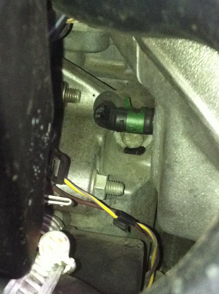

Ok I have a 1994 Turbo 850 wagon. At idle there is a hissing sound coming from just under, and off to the right of the power steering pump. Or just under and off to the right of the thermostat, and it's Guage . I would upload a photo, but you guys have no way to simply attach a photo with out entering some lousy URL etc!!! Pisses me off! Anyway I would like to know the function of this vacuum line. It looks pretty easy to replace . Any suggestions would be great.

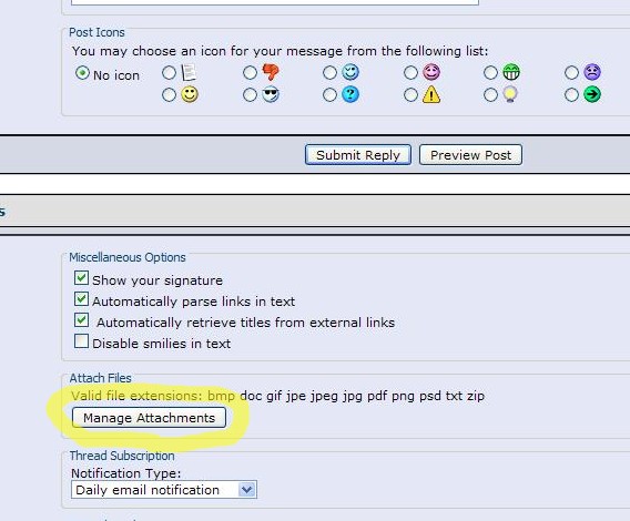

As for an easy way to attach photos, there actually is. I had about 10,000 post before someone told me to go ADVANCE and then click MANAGE ATTACHMENTS to upload photos in seconds.
Old Jan 25, 2013 | 07:22 PM
Here you go. Since my last post I copied the page, saved it, opened it in a edit program, cropped it, highlighted the button, saved it, uploaded it here and then typed this message.

Ok now we're getting somewhere. See photo. What it it's function? Looks like an easy fix. My car runs great - this hiss, or vacuum leak which I'm sure is unacceptable. More info on this would be great. Thank again for the photo sugestion! Duh!
Old Jan 25, 2013 | 07:32 PM
That is part of your PCV which is torn open. If you don't know the age of your PCV, just replace the entire system ASAP. I pulled one a few days ago and the lower block hole was 95% blocked. Not good. If the system has been serviced, just replace the elbow with a Volvo one (or silicone tube).

Yeah, the fragile black hose your talking about is the one that is cracked; right at the elbow. See photo.
Thank you. Off to the parts store .
