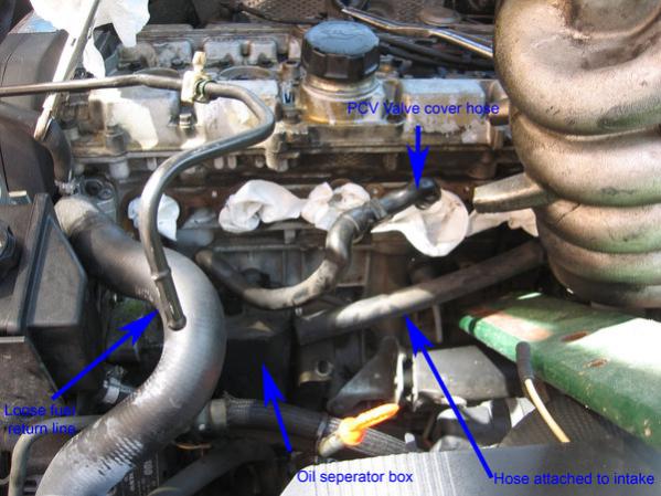

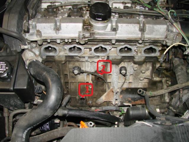

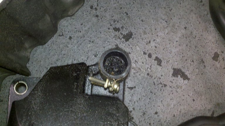

Make sure the openings that the PCV mounts to are open. If you have to open them up the stuff the drops into the pan is what you want to get drained out after you do the job and drive it a bit. Adding some Seafoam and putting a few miles on it before you start the job might help soften it up a bit if there's something there.
