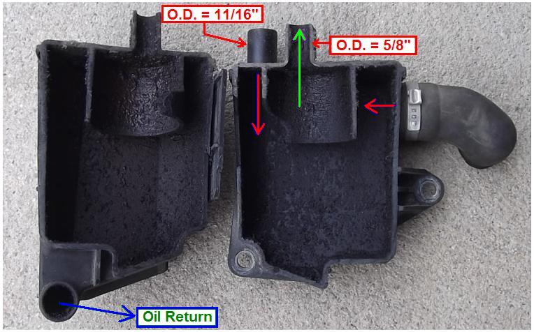

But . . . it's not so much the PCV system that's "important" as it is to regularly change the oil. Under normal conditions the only thing that goes bad is the vacuum lines from age. The black box really doesn't need to be a replaceable item like an air filter unless the owner neglects doing LOFs in a timely manner for their driving style. Short trip driving needs to be changed more often as the engine doesn't get a chance to cook off the moisture with sustained heat.
The black box is an oil separator to allow oil mist to drop out of the flow of crankcase gases going to the intake to be burnt.

That is a pretty awesome picture might I add. From what I understand is that the pcv will naturally get clogged and lose its effectiveness just like any other part. As you said definitely the lines crack and such first, not so much the box. And yes a lot of this can be solved by doing regular oil changes like you stated. Using good oil and changing it as needed is best.
