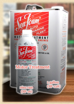

I had the same thing.
New hoses may help, they surely wouldn't hurt and they look good .
Tune up if not done lately is always a good idea but your engine is sucking against a restriction. No amount of tune up is going to get more air through that tubing to the engine.
Plugged intercooler .... best way to tell is pull the hose off the bottom of the intercooler and see if that top hose still collapses. If it doesn't, you know it's not the intercooler. With the hose off, be careful it doesn't ingest anything !!
I think you have a turbo that is hanging up. Mine used to do that only when it was cold out, around 32 and below. Sometimes it would get better once it warmed up and other times it would get worse or stay the same. If I tried to rev it up it would climb to around 2,000 rpm and go no further. If I tried to drive it and it did get a bit better it would barely make it to 55 and if I came to a hill it would lose speed trying to climb it even if it wasn't much of a grade.
Mine had terrible maintenance when I first got it and I'm pretty sure it was badly coked up inside the turbo from lack of timely LOF's and most likely never being idled down before being shut off.
I would recommend using an engine flush and let it idle longer with the stuff in there than what they recommend. You need it to get in there and break down the crud that may be impeding the turbo bearings. Also toss in some "Seafoam" after the oil change as it will put more detergents into the oil to help clean both the engine and turbo up. I have also started to get into the habit of tossing in a quart of quality transmission fluid a week or two before I do an oil change for the same reason. It's higher in detergents and helps keep everything clean. I don't use Seafoam myself but a lot of people do. Once you do the engine flush with a flushing chemical and you're doing the oil and filter I'd just toss in a quart of trans fluid to replace one of the engine oil quarts and yes just drive on it like regular oil until the next scheduled LOF. It's also good for quieting down lifter noise if they are getting a bit varnished up. I had a bad valve train rattle on start up too at first until I started to baby it with some maintenance.
It didn't happen to me once this year but my first year with the turbo I'm glad I had a second vehicle or I would have missed a few days of work. There were a couple times I started off for work I wasn't sure I was going to make it back home as instead of getting better I kept losing power.
You can also pull off the intake tube between the turbo and mass air flow sensor to see if it's spinning or if you can try to spin it with your finger to see if its stiff. Just be careful nothing gets sucked in !!!

I've added Seafoam, to the oil and some gas treatment to the fuel.

I am hoping the seafoam added to the oil will help clean the turbo, maybe that will get it going. ???
