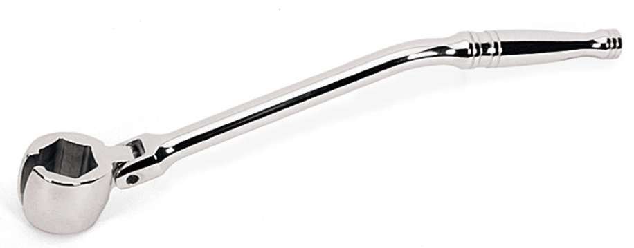

I'm glad I looked because it does seem you only have the one. I checked FCP and autozone and they don't list a "downstream" sensor.
You might need to heat it up and then as it's cooling spray it a couple times with the PB so it gets sucked in as it's cooling. You can wrap on the fitting with a hammer or if your aim is poor put a chisel on the fitting and hit it. Might help break the connection loose. But heat and a tight fitting socket are your best bet.
The sockets or wrench assemblies you can get as loaners from most part stores.
http://dodgeforum.com/forum/dodge-ca...yesterday.html
Attached Thumbnails how to get o2 sensor out-o2-sensor-wrench-2.jpg   how to get o2 sensor out-o2-7-pcs-wrench-set.jpg
