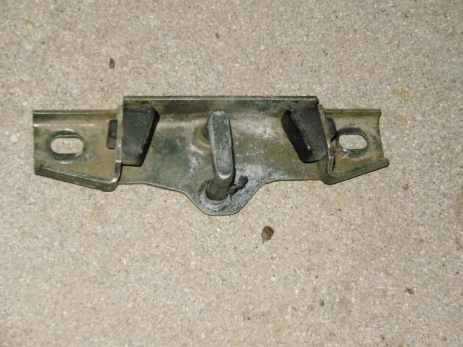

Step one was to repair the clips using a kit from IPD. Some of the old ones were broken so this help a little.
Step two as you can see in the attached pictures was to split a piece of hard plastic tubing and put it around the bar that the tailgate latches to. This replaces the original plastic that was around the bar. I also used Gorilla glue to fill and hold this in place.
Step three, if you look at the mounting holes in the first picture you can see that they are a larger than the mounting screws so I adjusted it so it holds the tailgate tighter. This probably did the most good.

The original strike had a plastic piece around it and I think the rattling starts when that wears off so there is to much slack and that allows movement. The little plastic tube fills the gap and adjusting takes up the slack.
