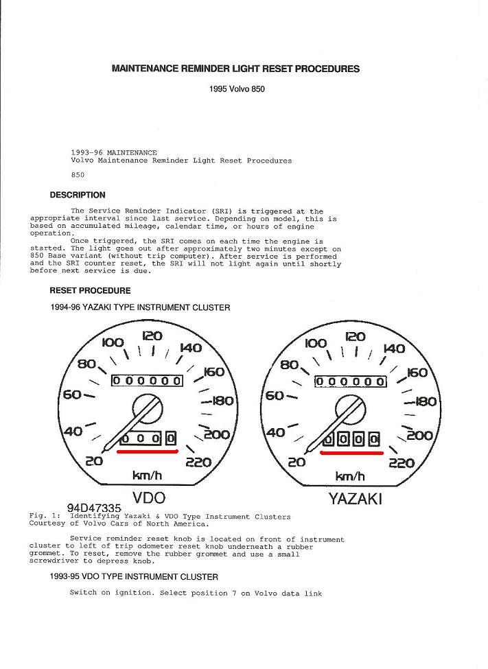

VDO = German
Yazaki = Japanese.
See attached.
JPN
