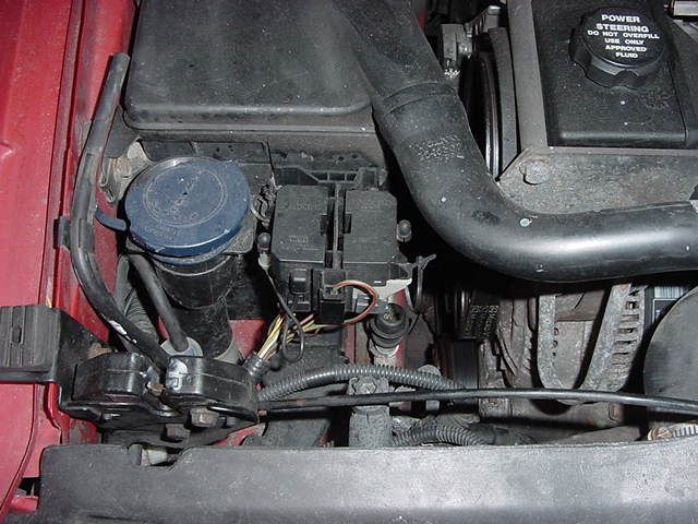

If your climate control lights are flashing, it has an error code stored. If it has OBD-I you check it from slot B1 in the diagnostic port in the engine compartment.
If it is OBD-II you'll need to get the codes read, maybe from Autozone. That will tell you if it is related.
Old Jul 4, 2012 | 07:47 AM
It does have OBD-I, it's a '95. It may also have a OBD-II port under the coin tray. But the OBD-I port is the best to use.

Attached Thumbnails I need more help :(-obd-i-diagnostic-port.jpg
