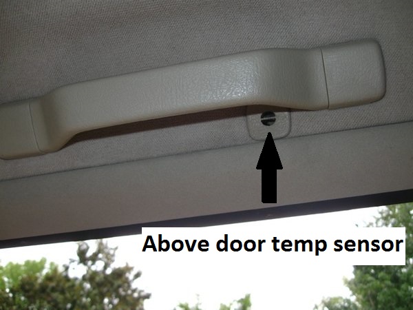

Look inside the car just above the passenger door. There is a tiny hole within the grab handle. Within the hole is a temp sencor that is fed by a small fan. That fan gets clogged with dust. Usually sucking on the hole with a vacuum will clean it out. Once cleanned out, the fan resistance should be reduced, the climate system will sense this and the fan will start working again. This should stop the code from setting again. I've never had to remove the sencor unit for any further cleaning.

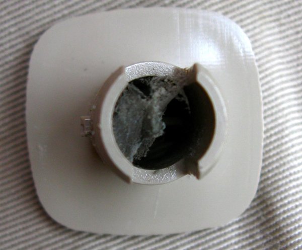

A little shot of compressed air can work wonders on them.
Attached Thumbnails interior temp inlet fan-heat-ac-interior-temp-sensors.jpg   interior temp inlet fan-heat-ac-interior-temp-sensor-dirty.jpg

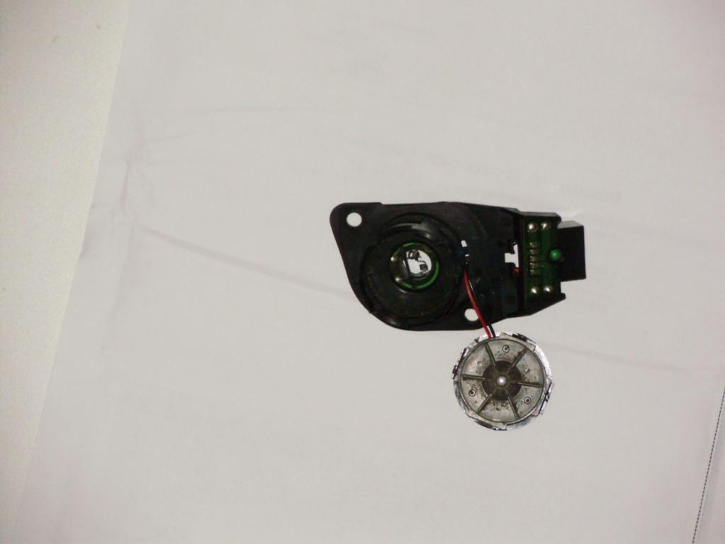

A little shot of compressed air would have worked out better for me than pulling the dust out with hemostats. At least it gave me something new to take apart. The attached pictures show the sensor and if you look in the hole you can see the little thermocouple that I broke the wire on.
Picture #2 shows the fan itself separated from the body of the unit.
