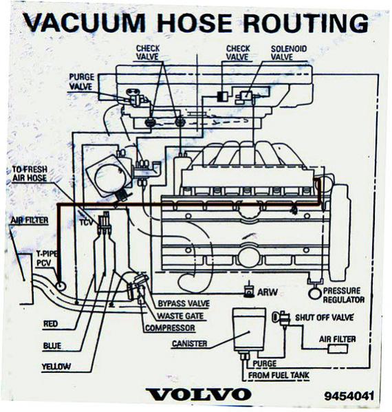

Is it the same problem that you had before you replaced the BCV & TCV. Did you check that the line for the "vent" on the TCV is the vent line leading to the air cleaner housing. The other two you can interchange and apparently did. The vent line being in the wrong place would surely make a difference.

what do you mean when you say you "mix & match" vac hoses on the tcv? There is a specific routing for them, which Kiss4afrog noted. If they are routed wrong, it will cause an overboost/fuel cut @ WOT. I speak from experience, because when I bought my 850, the hoses were routed wrong, and I was getting conditions like yours. This does not discount anything that others have posted, vac. lines are cheap enough - just put new ones on everything.
