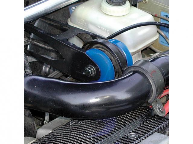

This would be that upper motor mount mounted near the brake master cylinder. The blue material is an aftermarket polyurethane replacement for the stock rubber insert. That insert can get pounded out of position or torn.

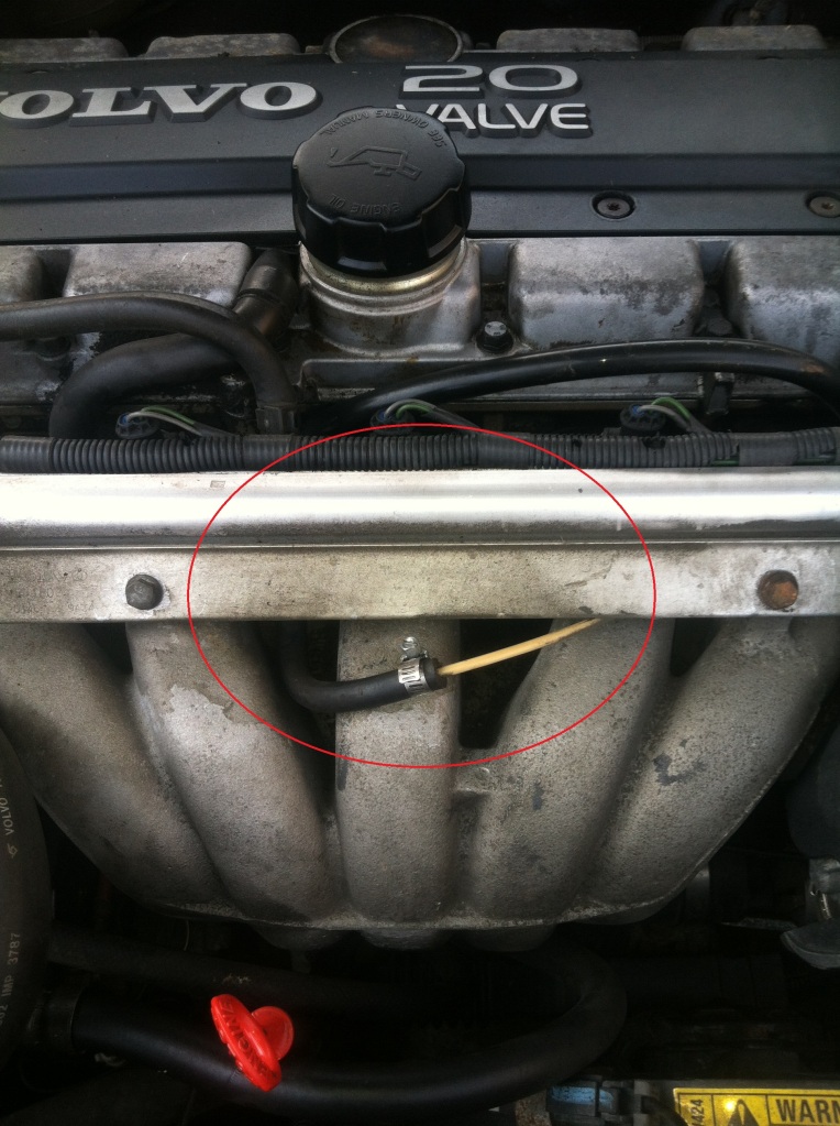

Does anyone have any idea what this is? I know it's not supposed to be like that and looks to be related to the fuel system, so it might be the cause of this problem.

The chances are good that the plastic vacuum tube was broken at some point. The line leads to the fuel pressure regulator and should have just a 90 degree elbow at the end of the tube. Looks like they used a chunk of hose to make up for what likely broke off.

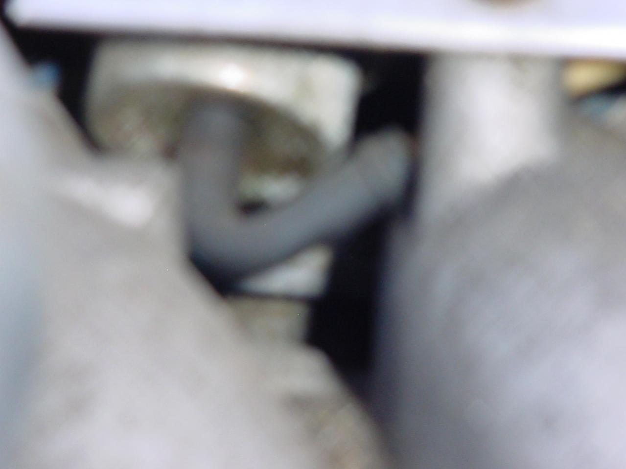

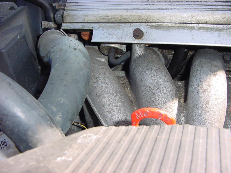

Sorry for the picture quality but that's the end of the fuel pressure regulator poking out from under the passenger side of the fuel rail between the intake runners. You can just see a small part of that yellowed vac line on the other side of the intake runner on the right of the regulator in the upper right corner of the picture.

Could that be whats causing the random sputtering and no start? I checked the fuel pump in the on position and it sounded good. Is there any way to test a relay with a multimeter to see if it works?

It looks like they did a quick and dirty fix with fuel line due to the sidewall size of that hose but as long as it's not causing a vacuum leak it isn't a problem.
After it's run for a couple minutes you should take it apart and check to see if you can see or smell any gas in that line. If you can then the diaphragm inside the regulator has ruptured and the engine will suck raw fuel out the tear in the diaphragm and into the intake and could very well cause the problem you are describing.
The purpose of the hose is to raise the pressure in the fuel rail under low vacuum conditions like open throttle to allow more pressure on the injectors so more volume of fuel flows through the injectors. Under high vacuum it should choke down the pressure as there isn't much volume needed to idle the engine.
