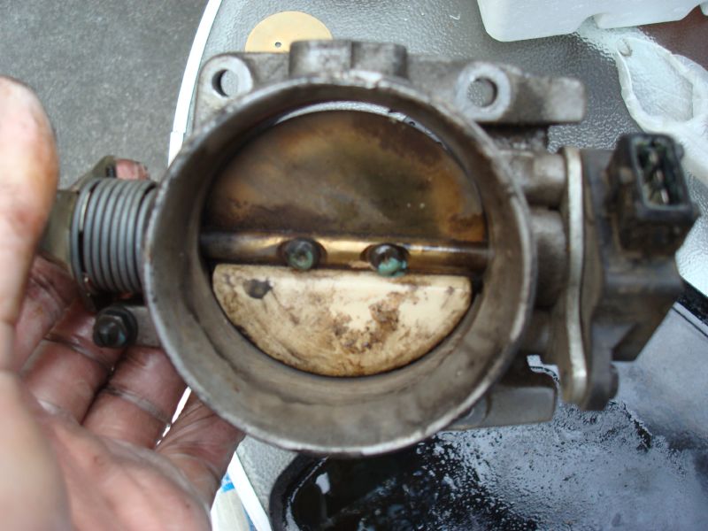

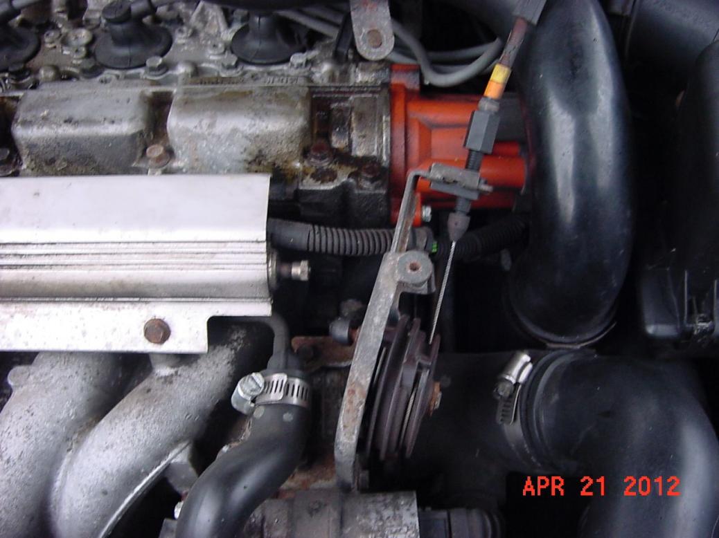

The throttle body is located below the throttle linkage (the black cover is removed in the photo). The black tube elbow attaches to the front of it. Make sure if you try to clean it you only use throttle body cleaner and not carb cleaner. You might want to pull up a youtube video or two and watch how someone else has done theirs. You should have a throttle body gasket on hand if you try to remove it for cleaning as it's likely the old one will rip coming off.

The reason most throttle plates are kind of a yellow is that they have a coating to keep them from corroding. At idle that plate has to almost perfectly block the bore and if it deforms in any way, ie rust or corrosion there is a chance it will start to stick or jam when closed at idle. That "yellow" is a protective coating and carburetor cleaner can eat it away leaving the plate exposed to combustion gasses and moisture. Throttle body cleaner is designed to clean without attacking that coating. If you use carb cleaner sparingly you might be ok but it's safer to spend 5-8 bucks and get a can of the right stuff.
Thanks for the tip, makes sense for me, i will be using throttle cleaner now :-)
