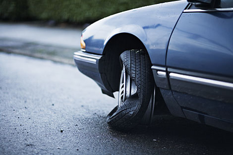

If you're good or if you remember to tell the shop about it you can do a five wheel rotation each time and you'll end up wearing all five out fairly evenly.
What isn't said is that if your car is front wheel drive and you get a flat on the front then you are supposed to move a back tire to the front and put the space saver on the rear. Opposite if it's rear wheel drive. The space saver in almost all cases will be a smaller diameter and it will stress the differential heavily.
