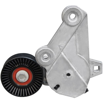

IPD $29 plus shipping, or get it on Ebay. Search "volvo serpentine belt tool 4708" and it's under $20
While you have the belt off you should also service the tensioner. The manual recommends it be disassembled and greased every 30K.
OR ....... replace it with an aftermarket tensioner if it's getting loose and then it will work with a 1/2" breaker bar
