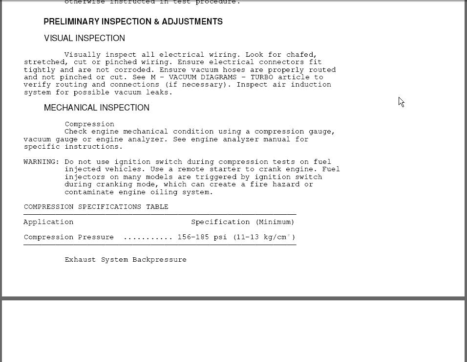

I dont know what your car is yet but here are the specs for a turbo.
If you survive the compression test and move to replace the PCV and seals, dont stop at one seal. The rears are very easy to replace the fronts are just as easy but there is a timing belt in the way which makes it harder. But, if you dont know when the timing belt was replaced last, now may be the time.
Points for leaving the dip stick out a bit until this is resolved. Good call and hopefully saved you from MattyXXLs curse.

OK... I found the specs for the non-turbo 2.4L... Compression Test - Volvo S70 GLT, 1998
I quote....
Compression on a turbo should be between 156 - 185. On the NA (naturally aspired), non turbo motor, 189 - 219.
Holy smokes. I figured the non-turbo motor would have been less PSI. Interesting.
Anyway, I'm ready to test. Just want to make 100% sure it's OK to do a compression test with the serpentine belt removed. I don't see why not, but I'd rather be safe than sorry.

Finally got around to testing this... and each cylinder was slightly over 210 psi.
Very good news. I guess that means it's worth doing the whole shebang --- timing belt, tensioner, idler, water pump, pcv system, & cam seals.
