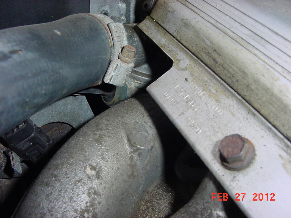

Old Feb 27, 2012 | 09:08 AM
Originally Posted by Turkey_Sandwich
The coolant temp sensor is located on the thermostat housing. Left side of motor, as viewed from the front, just beside the intake port for Cyl 1. No it would not necessarily trigger a DTC if failed. It could read low or high but still fall within operational parameters.
What he said.
The CTS is in the lower half of the thermostat housing just under the upper hose. You can see it at the bottom of the hose clamp in the picture.
Attached Thumbnails Misfire will not go away!!!!!-dsc01137.jpg   Misfire will not go away!!!!!-coolant-temperatur-sensor-new.jpg
