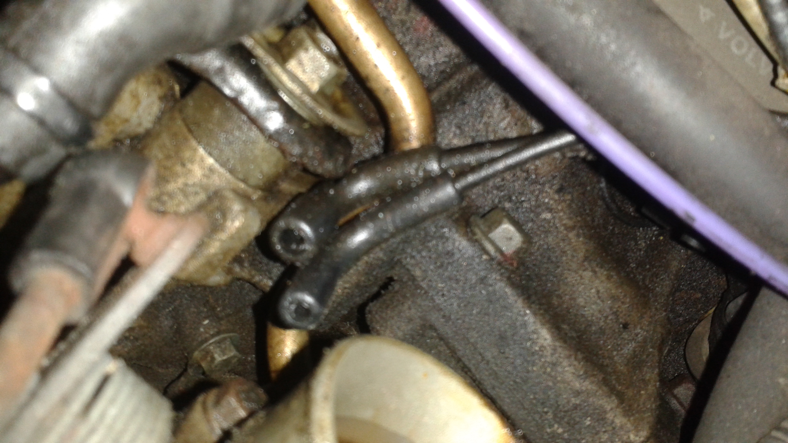

Went to replace a broken & clogged Flame Trap and noticed two vacuum line that are not connected. Attached are some photos. Any suggestions????
1994 NA 850 Wagon
Thanks,
-Kevin

http://www.matthewsvolvosite.com/for...hp?f=1&t=65002
and this
https://volvoforums.com/forum/volvo-...diagram-48749/
great write ups of where the non-turbo vacuum lines go.

This will help a lot
Thank you.
The Flame Trap arrived with no O-Ring, waiting on replacement.
Project for this weekend.
-Kevin
