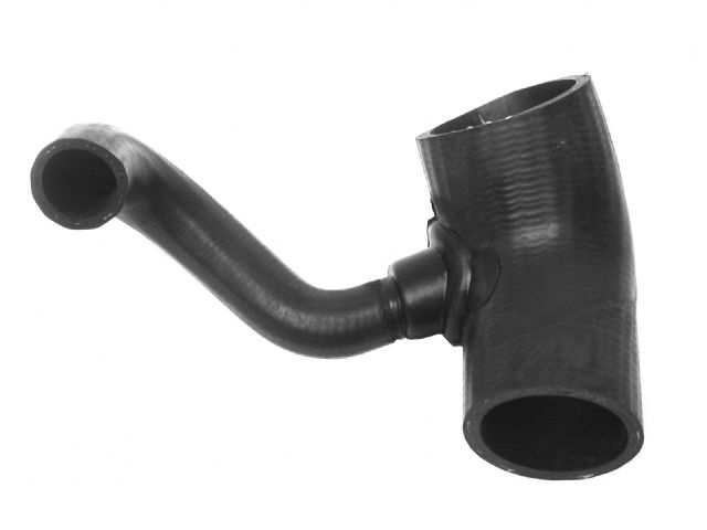

Update: I removed the throttle body cover to find a tree under there with three hoses attached to it, there is a fourth port open do it need to be plunged some kind of way? Also the hose shaped like the picture has two holes in it and the clamp is missing on one end . The holes are from a clamp on another hose just behind it. I still have to wait until the silicon ones come some time this week and I'll update then.

The hose with that's missing the clamp is 19 and that hose is also the one with the holes in it. The hose that it's connected to the lager one has some kind of nasty silicon substance coming out of the back side of it. Which one would be the IAC hose in this picture? Oh BTW 22 was replaced with the motor. This hose goes into the throttle body and has a little hose coming off of it.

19 Is a soft vacuum elbow that usually does not have a clamp. One of them connects near the turbo to the PTC valve and the other under the passenger side of the intake. Both will cause a CEL light and cause a little running issue. Not sure how much it will effect the preformance. The PTC does need to be clean and that is a major part of the PCV system.

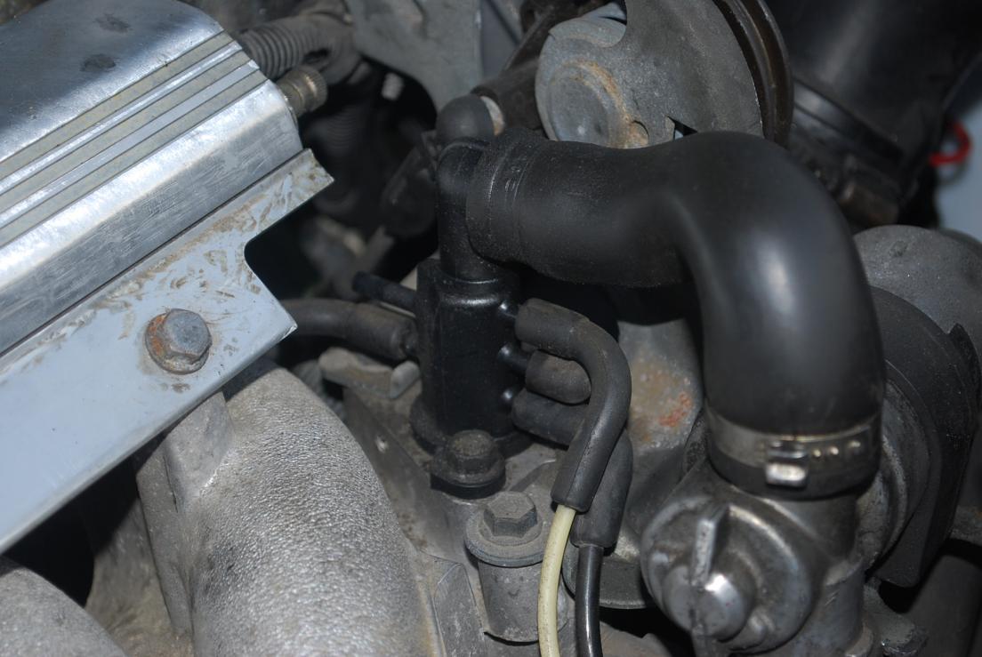

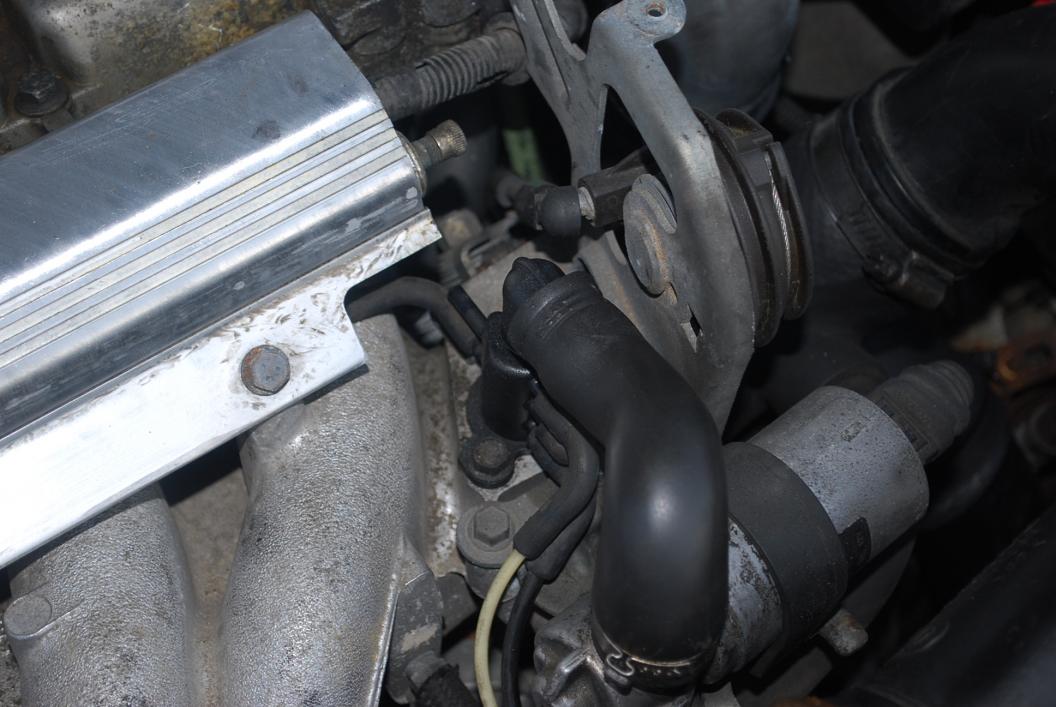

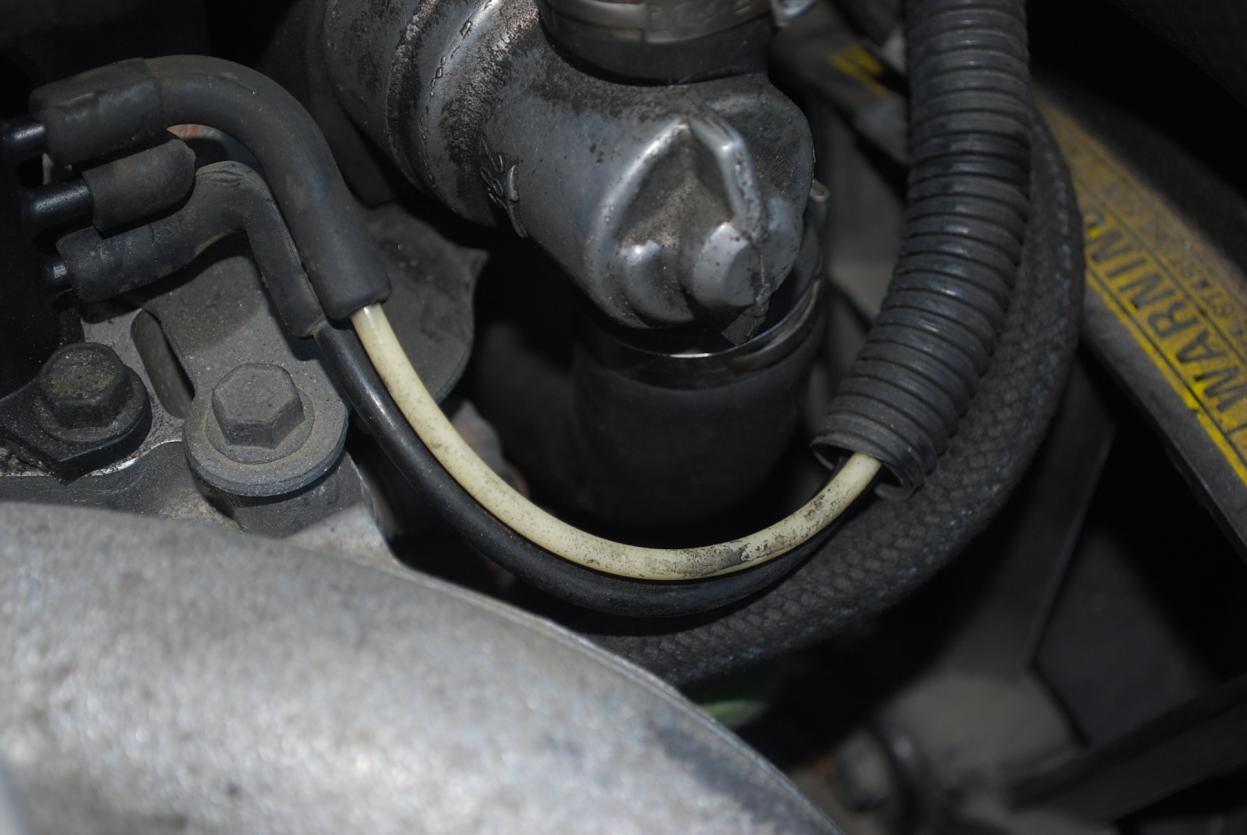

The hose on one end don't have a clamp and the other end is connected to something one one side there is another hose on the lower side, that hose has two holes in it. The tree that's in the picture looks like it's missing something one port is open. I apologize in advance for the motor being dirty the old one was polished I haven't had time or good weather to do this one yet.
Attached Thumbnails Need help-dsc_0264.jpg   Need help-dsc_0265.jpg   Need help-dsc_0267.jpg
Old Mar 14, 2011 | 06:26 PM
  #38
That is the idle control valve. I have the T-5R and the bottom two ports on mine are capped off, the other ports have the vac lines connected to them.
