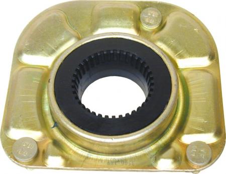

Common suspension problems include strut mount, spring seat, and sway bar end links.

the strut mount, is that the part with the bolt you can see from under the hood? that part squeks when you push down on the fender, compressing the suspension.

Strut mounts can be replaced. Spring seat is also there.

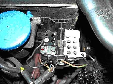

The underhood diagnotic panel is next to the windshield washer fill tube.
Read this: http://www.matthewsvolvosite.com/read-codes-volvo-850
190 something on an NA sounds about right. Where does the needle sit when it's stone cold? Maybe someone took the cluster apart and didn't get the needles back on right. Cold engine should be just a bit below the white arch.
Strut mount is two parts. There is the rubber spring seat but also a bearing plate. Not sure the rubber would make the noise but the bearing plate can.
Attached Thumbnails Need help with '94 850 NA-obdi-diag-panel-5.jpg   Need help with '94 850 NA-instrument-panel-metric.jpg   Need help with '94 850 NA-suspension-front-coil-spring-seat.jpg   Need help with '94 850 NA-suspension-front-strut-mount.jpg

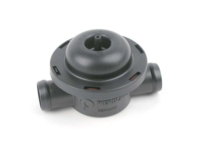

But of greater interest is this pipe which "should" connect to the part near it. But that part's nipple seems to have melted off.
What is this part, and what does it do? The hose wraps around and then goes to a metal line which leads under the plastic spark plug cover (the thing that says volvo on it)
Could this be part of my cold start stalling issue?

That would be the air injection shut off valve.
SAS Air Injection Valve
Attached Thumbnails Need help with '94 850 NA-air-injection-system.jpg   Need help with '94 850 NA-emissions-air-injection-shutoff.jpg
Forgive my newbness, but if I read that right then it controls my Idle Air Control Valve?
Is this part sitting where it should? It certainly looks like it got melted. Should it be mounted higher up on something?
will this have a big effect on how the motor runs, or just emissions?
Starting to think I bought a basket case
I hope I can find this part for less than $80. Ill have to check for a used one.
I pulled the part out 2 take more pics. I dont think its supposed to be all melted like that...LOL
